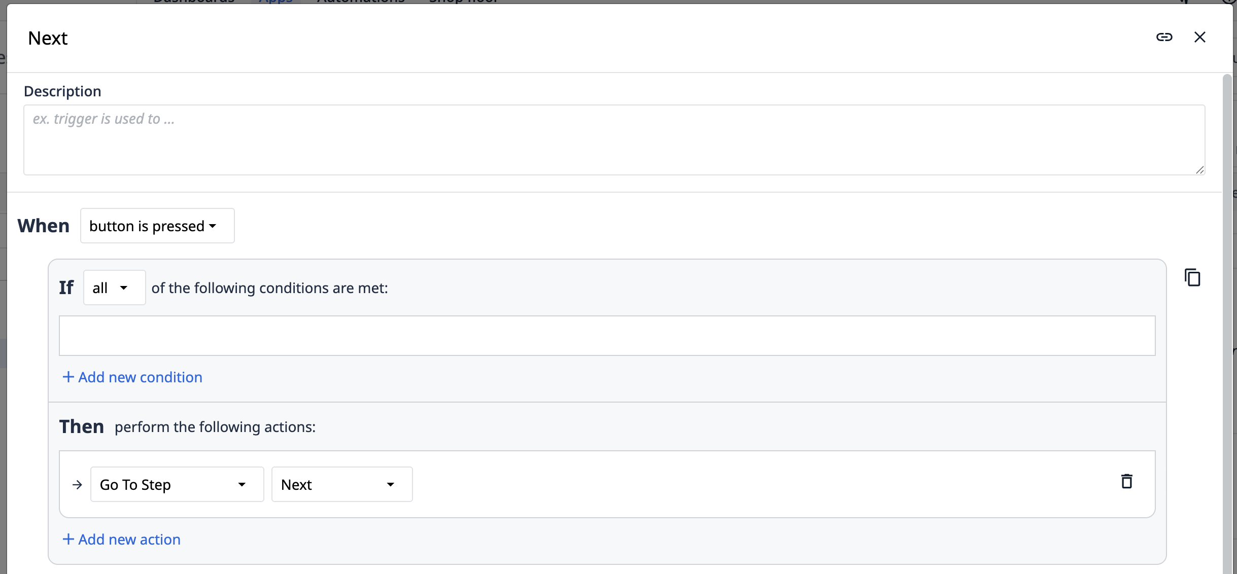

Triggers can be simple like the example below:
ex simple trigger
When a button is pressed, then go to the next Step.

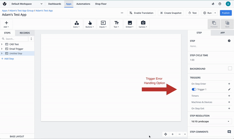

When an action in a trigger errors, the remaining Actions in that trigger are skipped/cancelled:
After an error, by default, any remaining triggers in the queue and in the trigger event will not execute for the following app and step-level triggers:
  • App started
  • App completed
  • App cancelled
  • On step enter
  • On step exit
For all other types of triggers (e.g. When button is pressed), the “Stop remaining triggers on error” toggle is disabled by default.

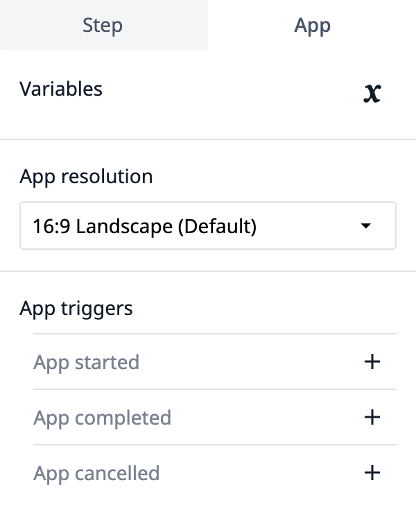

App level triggers
You can apply App Level Triggers to the following events:
  • App start
  • App completed
  • App canceled
Access app level triggers from the App Tab.
App tab triggers
Learn more about app level triggers here.

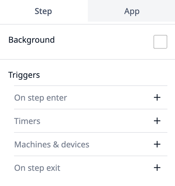

Step level triggers
You can apply Step Level Triggers to the following events:
  • At regular time intervals (“time fires”)
  • When there is an input from a machine or device (“machines & devices”)
  • When the Step is opened
  • When the Step is closed
Access step level triggers from the Step Tab.
Step tab triggers
Learn more about step level triggers available here

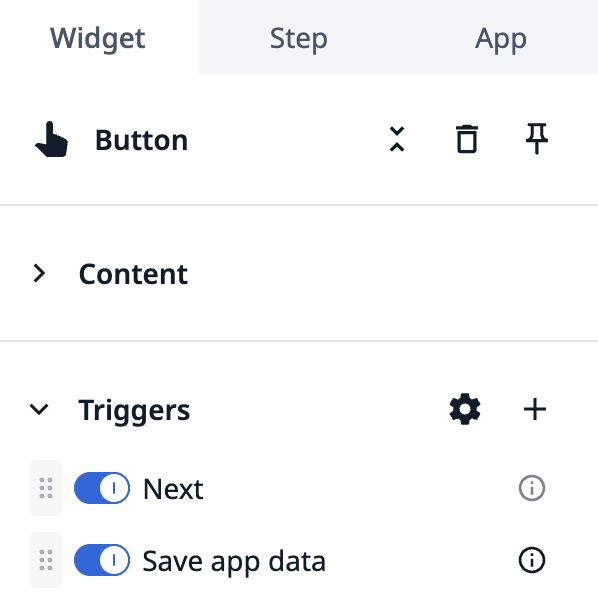

Widget triggers
Widget triggers are activated when a button is pressed.  There can be multiple button Triggers on a Step that are triggered when the respective button is pressed by an operator in the Tulip Player.
Select the desired widget, and then access widget triggers from the Widget Tab.
Widget tab triggers
Learn more about widget triggers here.
Create a trigger
  1. From the Side Pane, click + in the Triggers section. The trigger editor will open.
  2. Name your trigger to identify what it does in the app. You can also include a description for more details.

  • Configure triggers to accommodate errors
    Triggers should be configured to proceed or stop in the event of an error. A Trigger can error due to invalid inputs, an execution error, or a failed connector function or table write attempt.
    • When a trigger is configured to proceed, the trigger that errored will stop, but the next trigger will proceed
    • When a trigger is configured to stop, the other triggers in the Trigger Event will be cancelled.
Trigger error handling ex
