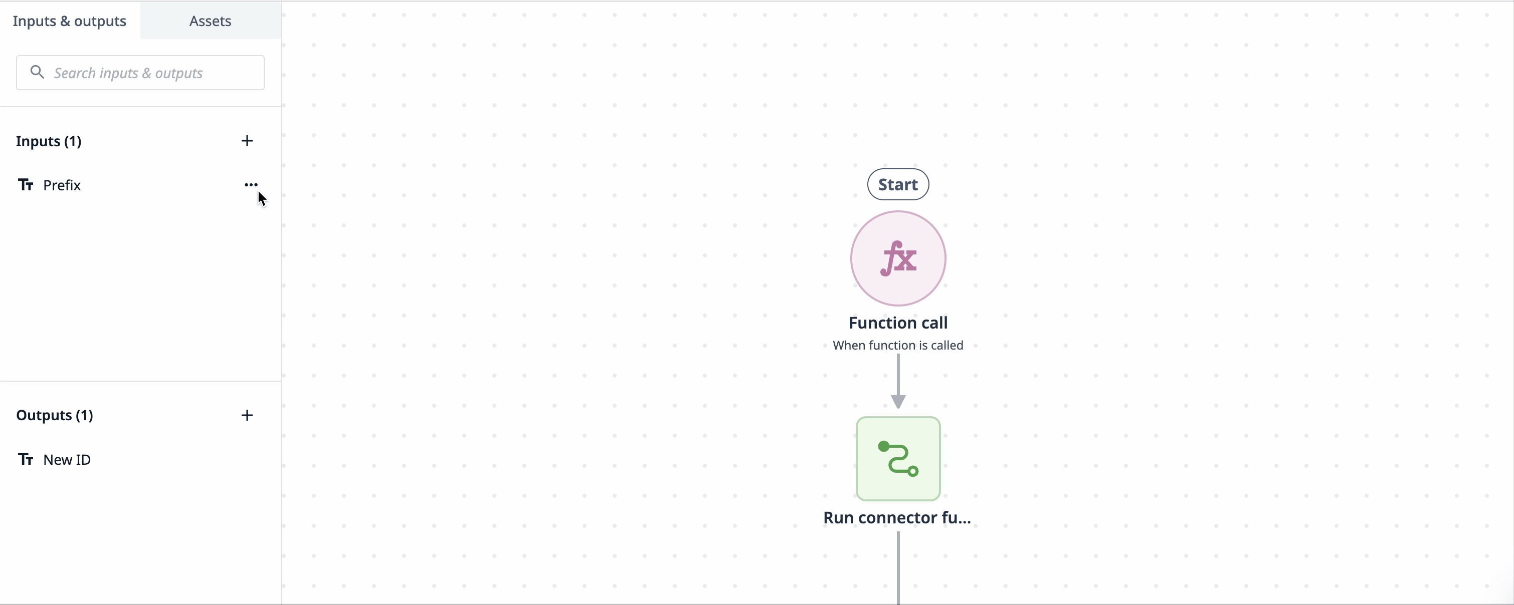

Inputs and Outputs panel
The Inputs and Outputs panel lets you create and view inputs and outputs related to the function. Inputs and outputs pass data in a function.
To add an input or output, click + in the top right of each section and select the date type.
To edit, duplicate, or delete an input or output, click the three-dot menu.
edit function input
In the above image, the input is italicized because it is not in use.
Once an input is used in the function logic, you can select Where used to see the logic blocks that use it. Click the block name to open the configuration in the details pane.
functions view input where used

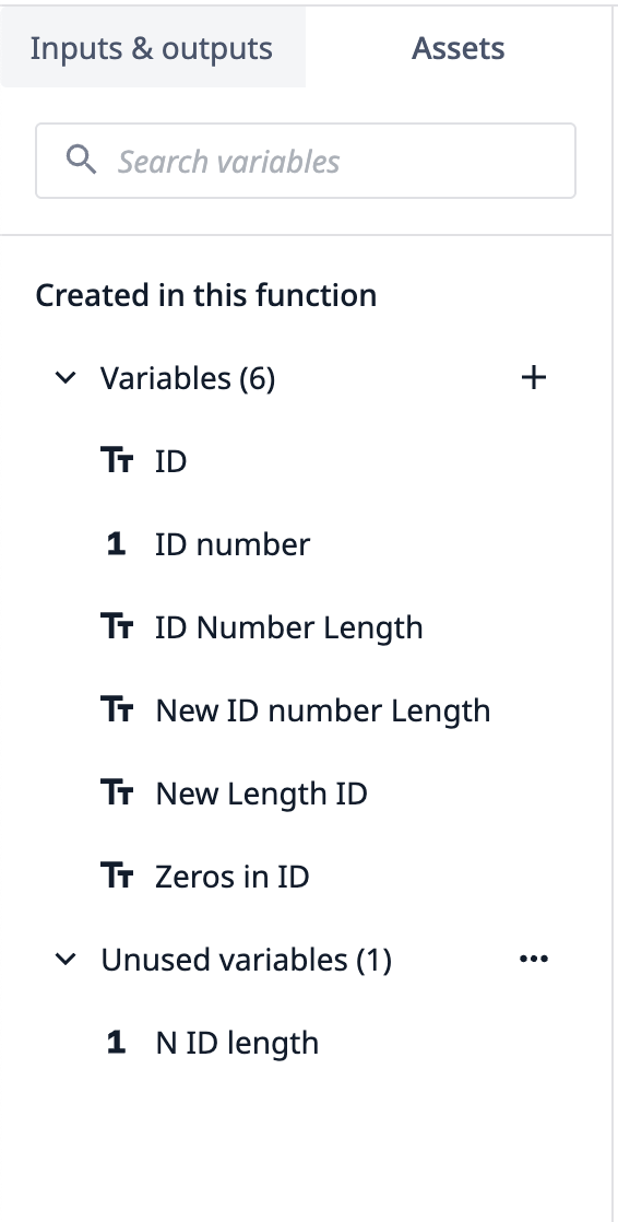

Assets panel
The Assets panel lets you create and view variables related to the function.
To create a new variable, click + next to Variables.
A new variable will appear under Unused variables until it is used in a logic block.
Functions assets tab

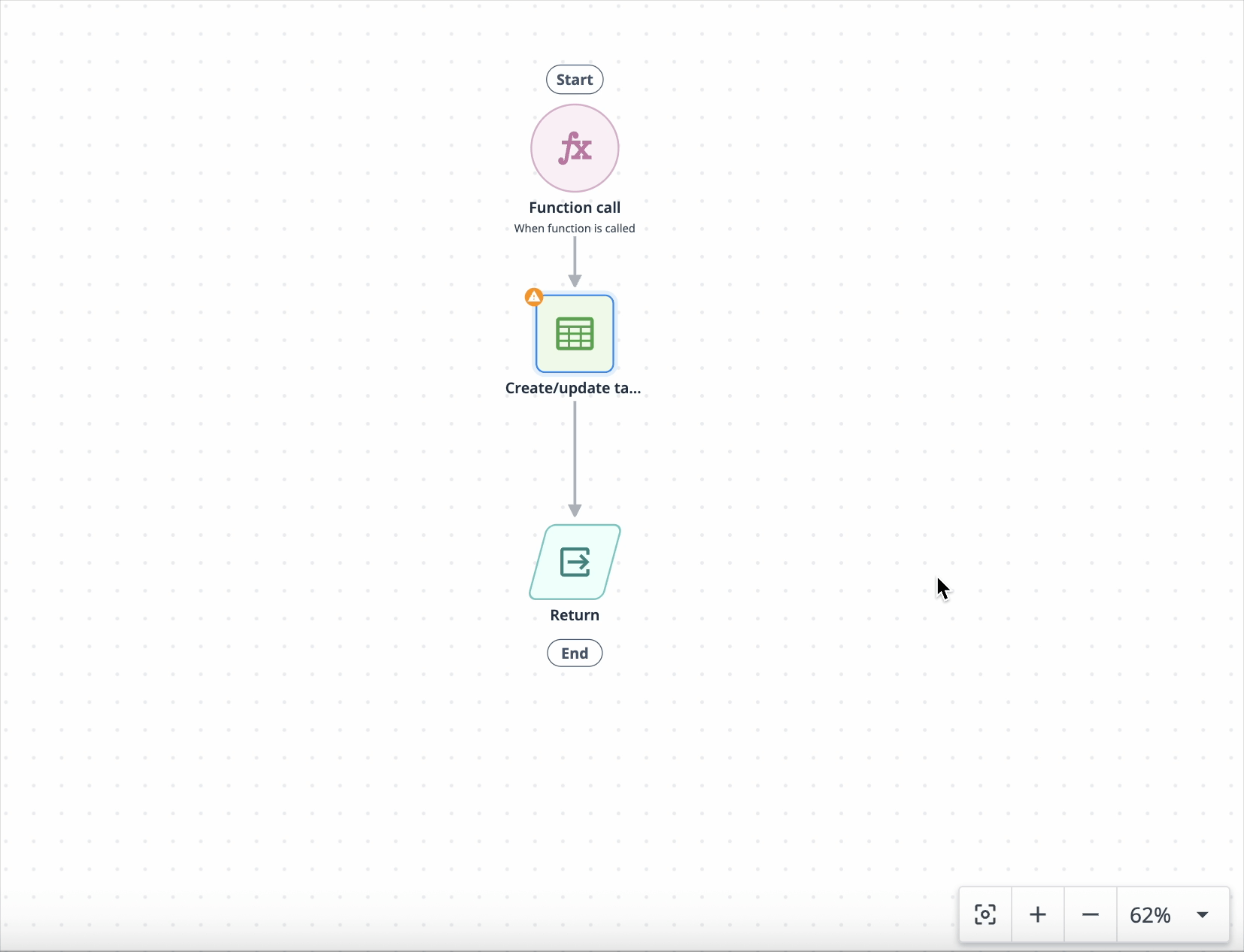

Canvas
The canvas is a visual editor where you add logic to the function. The arrows between logic blocks show the consecutive steps in the function.
To build a function, hover over the line between two blocks and click +. Then, select an action or control flow from the menu.
Functions canvas new block
To rearrange the flow, click and drag a block to a different arrow.
functions canvas
Use the navigation controls or your mouse/trackpad to zoom in and out of the canvas.

Call
Functions begin with a Call, the event that references the function.
Inputs must be configured in the function call logic.
Return
Functions end with a Return, the termination of the function execution.
Outputs must be configured in the return logic.

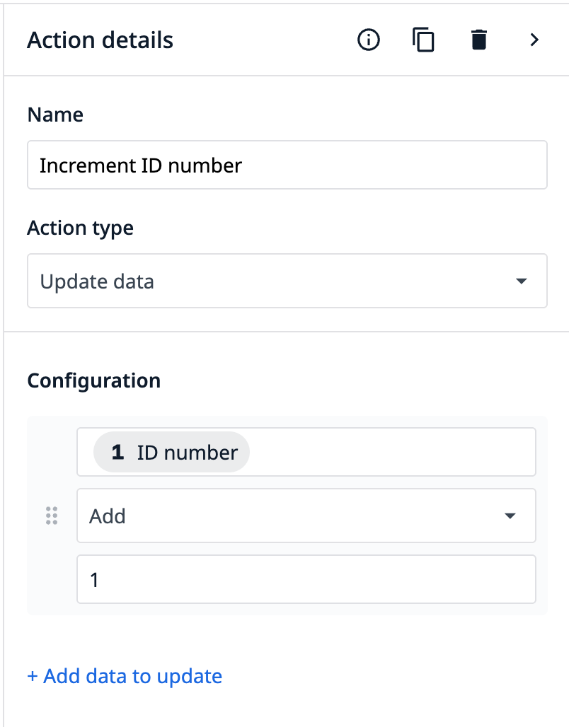

Action
An action block can retrieve an existing table record, manipulate data, or run a connector function.

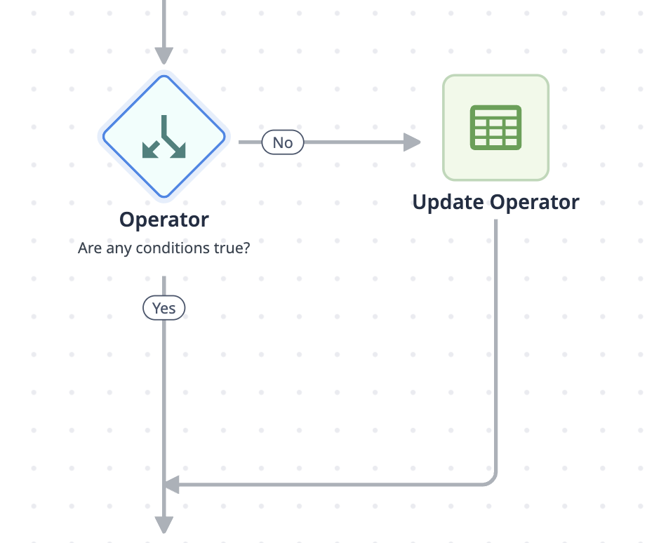

Decision
Decision blocks are conditional logic that always have two paths–”yes” and “no”.
functions decision block

Details pane
The details pane is a reactive configuration panel for viewing and editing function logic blocks. Select a block in the canvas to open its details.
Functions details pane

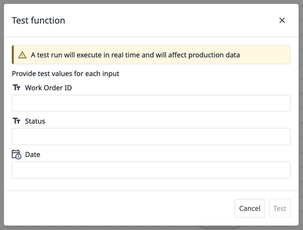

Test
Click Test in the top right corner to test a function.
functions test modal
If the function has inputs, you must enter a value for each input before testing.
Warning
A function test executes in real time and will affect production data.
For functions that run connectors, you can select the environment in the Test modal. The default environment is Development.
